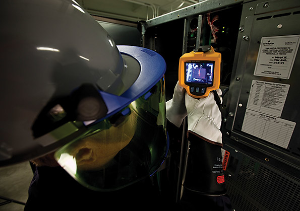

Electrical workers need to play an active role in protecting themselves when working near energized equipment.
In addition, the latest version of NFPA 70E: Standard for Electrical Safety in the Workplace has made changes to safety, maintenance, and training requirements. Changes were made to the ways in which electrical risks are evaluated to help prevent exposure to electrical arc flash hazards and to support compliance with OSHA requirements.
While employers are obligated by law to follow OSHA regulations for creating a safe work environment, electrical workers need to play an active role in ensuring their own safety on the job. This includes adhering to OSHA requirements and following the specific safety procedures and practices for working on live electrical equipment as outlined in NFPA 70E. The following best practices reflect the latest codes and standards. Keeping these in mind can help keep you safe at work and could even save your life.
