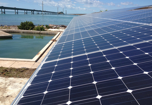

NFPA 70E has expanded its coverage of DC power systems, which includes PV arrays.
Up until publication of the 2012 edition of NFPA 70E, both of these documents had focused almost exclusively on alternating current (AC). However, this is no longer the case. Additional information has been included in the 2012 edition of NFPA 70E to help protect employees in workplaces where direct current (DC) voltage sources are present, such as large battery systems for telecommunication, data center, photovoltaic, and electric vehicle charging systems — to name just a few. Estimates are that the industry’s understanding today of DC hazards is about where it was 15 to 20 years ago for AC hazards. With the collaboration of the IEEE Stationary Battery Committee’s Code Working Group and the research/development community, however, the NFPA 70E technical committee is adding rules to the standard to close the gap and address these hazards.
