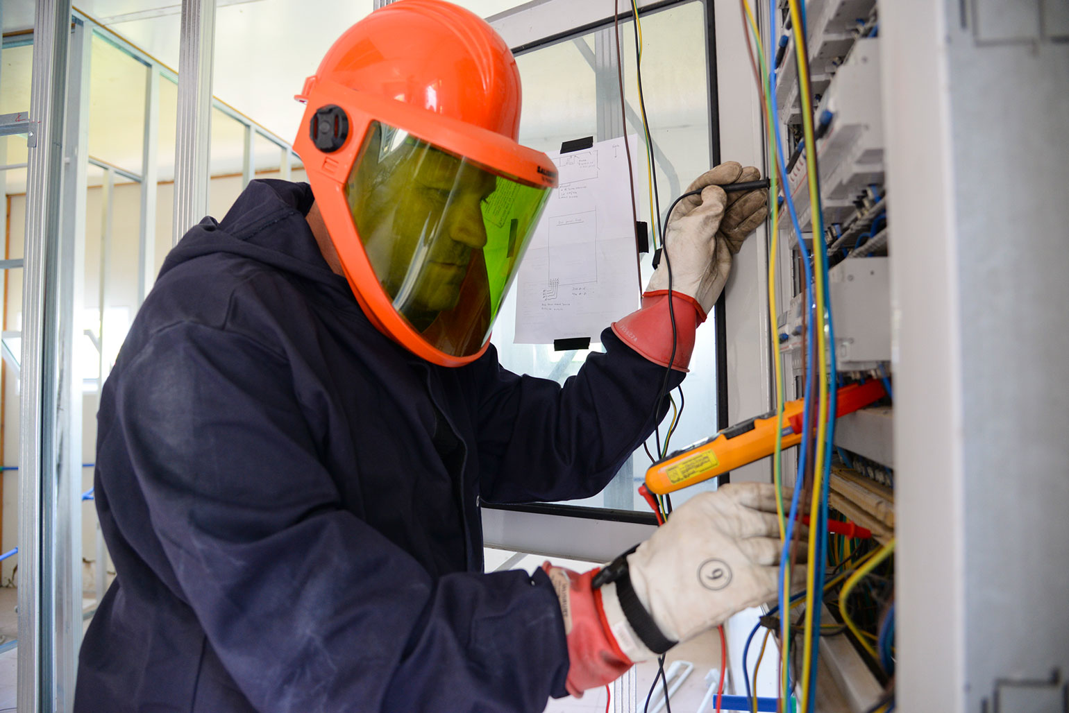

You and another electrician arrived onsite and got cleared through security. Your next step will be to unload equipment and get set up for the work.
The analysis done during the job planning showed that your arc flash PPE needs to be rated at 40 cal. But when you open your kit, you discover the helper packed a 20 cal kit instead. Your coworker checks his kit and finds the same problem. Under the old setup, this would not be a big problem; one of you would run back for the PPE or text the office to have a runner bring it to you.
You and your coworker discuss whether to proceed with the lower-rated PPE or delay the job by four hours until a runner can bring the correct PPE. You do have about an hour of other work you can do. The three hours of doing nothing will cause a schedule delay.
