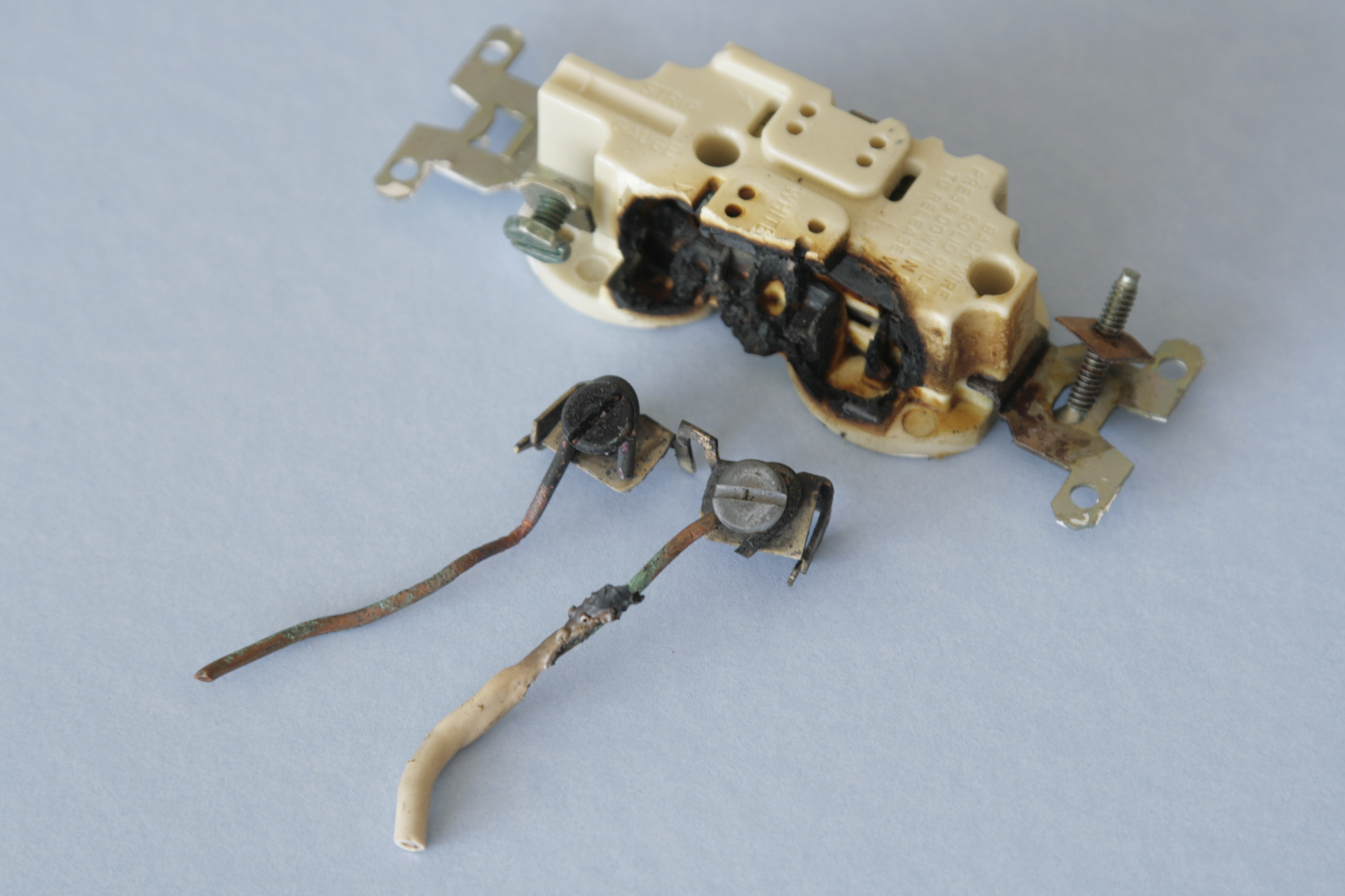

The damage resulting from a small arc flash involving a 120VAC duplex receptacle within a single gang box.

Arc flash incidents occur when there is an electrical discharge between two or more points. When there is a fault or short circuit between two electrodes of an electrical distribution system, an arc may be created. If the energy is large enough, the arc has the potential to instantaneously create intense light/heat and pressure, resulting in a violent blast and vaporized material.
Arc flash incidents are associated with creating a short circuit within man-made electrical systems. So, the higher the energy potential within the system, the greater the magnitude of consequences if an arc flash incident were to occur. For example, solid copper is used as a conductor in many distribution systems. When solid copper changes state to gaseous copper, it expands to 67,000 times the original volume of solid copper. This happens instantaneously. So, if a solid piece of copper approximately the size of a small coin was to experience a short circuit, it would instantaneously expand into a burning gaseous metal cloud the size of a refrigerator. If a person is close to the location of a high energy arc, the individual may be engulfed and impacted by the arc flash instance. A few examples of injuries that an arc flash incident may cause are:
  • Third degree burns — Molten and high temperature gaseous material may burn skin, eyes, clothing, lungs, etc.
  • Hearing damage — Air pressure instantaneously spikes, creating a high decibel soundwave capable of temporarily or permanently damaging hearing.
  • Vision damage — Eyes are susceptible to third degree burns. An arc flash incident occurs almost instantaneously, which means you are not able to blink in time to protect your eyes. This may lead to impaired or loss of vision.
