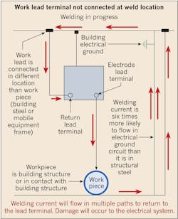

Let’s consider the mobile welding unit called in to do a weld repair at a facility. In a typical commercial or industrial building, the structure is a steel framework; many welders think a good place to attach the workpiece lead would be the nearest steel column near the parking spot for their welding rig — after all, no one wants to drag two cables all the way to the work site. This happens all too often (Photo 1).
The welder fires up his/her welding machine, sets 135A, and drags the electrode lead 100 feet to the work site. He is all set up, strikes an arc, and completes a perfect weld — everyone is happy.
But let’s go back and review the current flow in this specific welding circuit (Figure). Somewhere between 40V and 80V, either AC or DC current, the 135A must flow back to that workpiece lead connected to the building steel 100 lineal feet away — and that 100 feet as the crow flies is possibly four, five, or even 10 times that distance through building steel.
Let’s think about what is available to carry the welding current. There is the building steel, the building grounding system, the many electrical circuit ground conductors, and maybe a few coaxial cables. The truth is that there are many parallel paths to get that 135A back to the power source.
Welding current flowing in anything but the welding cables designed to carry it can cause significant damage in a building’s electrical system. Think what 135A will do to your 14 AWG to 6 AWG building ground conductors, electrical metallic tubing, cable tray, or possibly low-voltage cables.

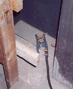

The truth is many times the damage is not immediately recognized — maybe there was no visible damage during this onetime event as the current load splits through those multiple paths. But that’s not always the case. I remember consulting on one fatality investigation in which the end result of stray welding current and an incomplete electrical inspection before power was restored. The victim died instantly due to a 420mA electrical current flowing across his chest.
The cause
The cause of course is always the same: improper placement of the welding workpiece lead. As electrical professionals, you need to be aware of any welding occurring in your workplace or area of responsibility.
Look at where the welder connects his/her workpiece lead. The workpiece lead should be connected to the work being welded or to the work table if it is a small piece being welded in a shop environment. Wherever the electrode lead is (where the arc occurs), the workpiece lead should be attached in the same location. One contractor enforced this by making the welders tape their leads together as a pair — wherever the electrode lead was taken the workpiece lead went too.
In the case of the fatality from stray welding current mentioned previously, the welder had connected his workpiece lead to a foundation structure bolt more than 100 lineal feet from his weld location. The result was that his welding current flowed through an electrical circuit ground system, destroying conduit fittings (Photos 2 and 3).

Let’s look at the welding circuit. It is a bit different than what electrical professionals expect to see. The power-consuming electrical arc is exposed and uncontained. In a typical electric circuit, all of the power is expected to be contained in insulated conductors and electrical apparatus. Power is consumed within connected insulated devices. We only expect to see an open arc during a serious fault, and then only when protection devices are set wrong or are installed incorrectly and not properly tested.
Let’s be clear though: A welding circuit has all the characteristics of any other electrical circuit. Whether an AC welding machine or a DC welding machine, the current delivered to the welding electrode must return to the power source and complete the electrical circuit.
The difference is the open arc
This is where the circuits differ. Consider the arc to be the connected electric device. However, as mentioned above, the arc is not contained in an insulated device, and any current flowing through the base metal is free to flow in any available path back to the power source. It must return to the power source through whatever path is available. Keep that path short, and there is less chance of the electrical current straying from the intended path.
In a welding circuit, the arc is the whole purpose of the circuit in that part of the circuit power is not contained. Couple that with an incorrectly placed workpiece lead, and you set the stage perfectly for high current extra-low voltage power to flow indiscriminately through copper ground circuits not designed to carry the hundreds of amps of welding current.
