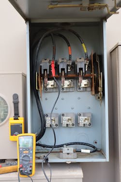

Photo 2. The NEC Sec. 110.7, Wiring Integrity, requires “completed wiring installations shall be free from short circuits, ground faults, or any connections to ground other than as required or permitted elsewhere in this Code.” Before installation of load side conductors into this 200A disconnect, the line side conductors are tested to ensure no ground faults exist. Load side conductors will be tested after installation.

Ground faults are undesirable. Not only is insulation degradation over time a culprit, but ground faults can also occur during installation work. Insulation can be scraped from a conductor as it is pulled through a conduit. A conductor can be pinched between a cover and its enclosure. Always verify a system is clear of ground faults prior to initially energizing the system. Insulation quality testing during acceptance and commissioning can identify problems that would prevent the proper functioning of equipment and systems. Measuring and evaluating the quality of electrical insulation increases safety and reduces unexpected downtime — a win-win situation.

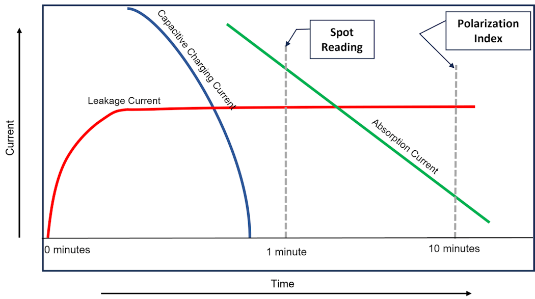

When applying DC voltage to a conductor, three separate currents flow. Just like charging a capacitor, some current flows to create a capacitive charge between the conductor under test and nearby conductors and from the conductor to ground. These are known as capacitive charging currents. Current flows also polarize any moisture or contamination molecules in the insulation. This is called absorption current. Finally, some current that is flowing is leaking from the conductor through the insulation into either the non-current carrying metal components of the system or into another conductor with poor-quality insulation. This is called leakage current. Fortunately, by applying the DC test voltage, the capacitive and the absorption currents will tend to read zero after a short time, and the remaining current flowing out of the conductor through the insulation is primarily leakage current.

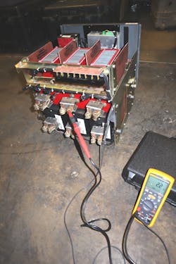

An insulation resistance tester or megohmmeter is the most common type of test equipment used to measure insulation resistance (see Photos 1a and 1b). Like the pump for a leak test on a piping system providing high pressure, the megohmmeter forces current flow through a conductor using a voltage greater than for what the insulation is rated. For example, 600V-rated insulation may be tested at 1,000VDC. A common error in the field is to use a digital multimeter (DMM) to attempt to measure insulation resistance. The DMM only produces a very small voltage; it is not enough to detect a breakdown in insulation. More sophisticated tests (especially for medium- and high-voltage cables/equipment) may use AC or a very low frequency (VLF) AC for testing.

Rule No. 1: “De-energize all equipment and conductors under test prior to beginning any test.” In other words, use an electrical lockout/tagout procedure to create an electrically safe work condition. Part of that procedure requires removing any stored energy as well. Longer cable runs and motors can store significant amounts of electrical energy. Many insulation resistance testers are designed to discharge these currents before and after testing. If this function is not available on the tester used for measurements, a static discharge stick with built-in resistance should be used for discharging circuits before and after tests.
Once this safe condition is properly verified, the test process can begin. Follow the manufacturer’s instructions to set up the test set. Insulation quality is measured from each ungrounded conductor to ground and between individual ungrounded conductors. The part of the system under test must also be disconnected from other parts to ensure no parallel paths to ground exist, which would give an erroneous reading.
The area under test is barricaded to prevent electric shock to an unqualified person. Follow the rules of shock protection found in NFPA 70E, Standard for Electrical Safety in the Workplace. The black test lead connects to ground — bare metal or the ground connection on the equipment. The red test lead connects to the bare ungrounded conductor. Insulation resistance will change with temperature changes. For consistency of readings over time, insulation temperature is measured, and charts are used to correct readings to a standard 40°C.
The appropriate test voltage is applied, and current begins to flow into the conductor material. Almost immediately, leakage current flows and will remain constant throughout the test. Just as current is used to charge a capacitor, some current is also flowing into the conductor to create the capacitive charge between the conductor and ground and between adjacent conductors. Any readings taken during the charging time of this capacitive charging process will result in an inaccurate leakage current reading. The capacitive current should be at or near zero after one minute. Taking a reading at one minute is referred to as a “spot-reading” test. It is the typical value used for determining insulation quality for many types of equipment.
In addition to leakage current, the absorption current continues to flow beyond the one-minute mark. As the impurities in the insulation are polarized, the absorption current drops to or at near zero. An increasing resistance value as the test proceeds toward 10 minutes is an indication of contamination on or in the insulation. The polarization index (PI) is the ratio obtained when dividing the 10-minute reading by the one-minute reading. A low ratio indicates questionable insulation quality.
Another method to determine insulation resistance quality is to divide the one-minute reading by a 30-second reading. This test is the dielectric absorption ratio (DAR). Follow the manufacturer’s instructions, or refer to the IEEE 43 standard for specific values.

Insulation resistance quality should be verified when electrical systems and equipment are installed as part of acceptance testing and commissioning of facilities. For example, nicked insulation in a conduit or pinched wires in an enclosure covering can be found. Identifying ground faults or short circuits between conductors is critical to startup. Section 110.7 of the NEC prohibits ground faults (see Photo 2). Measuring electrical insulation quality can be used during troubleshooting to identify faulty insulation as the cause for blowing fuses or tripping circuit breakers. NFPA 70E requires the cause of a blown fuse or tripped circuit breaker to be determined prior to replacing the fuse or resetting/closing the circuit breaker.
