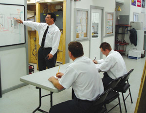

Putting theory into practice. Building an actual training center with a classroom is another step in the right direction because it gives you the power to simulate training in a safe learning environment (Photo). The room should have a whiteboard, television, video equipment, and working systems created to simulate what they'll find in the field, such as a loose neutral, a burned up phase conductor, or an overloaded circuit. To effectively teach and learn the electrical trade, you need to use multiple learning experiences — seeing the material in videos, reading it in books, and, most importantly, learning hands-on information in your in-house training center.
