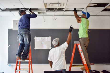

Photo courtesy of NGLS
Contractors install a connected lighting system in an NGLS Living Lab.
