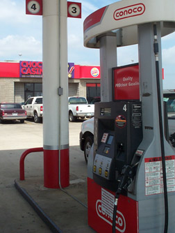

Alan Christofk, a superintendent with Gephart Electrical Construction in Stillwater, Minn., found this unique installation at a gas station
All references are based on the 2008 NEC.
OFF-THE-SHELF ITEM
Alan Christofk, a superintendent with Gephart Electrical Construction in Stillwater, Minn., found this unique installation at a gas station near Durant, Okla. “EMT conduit ran down the concrete pole support for the canopy, terminated in a ¾-inch shelving bracket, and ran across the concrete slab and into the gas pump,” says Christofk.
This ridiculous installation doesn't meet the requirements set forth in Art. 514, Motor Fuel Dispensing Facilities. As per 514.4, “All electrical equipment and wiring installed in Class I locations, as classified in 514.3, shall comply with the applicable provisions of Article 501.” In addition, 514.7 states, “Wiring and equipment above the Class I locations as classified in 514.3 shall comply with 511.7.” Standard shelf brackets are definitely not an approved conduit for electrical conductors.
