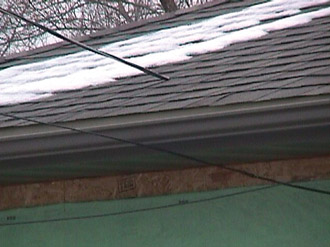

CABLE DISAPPEARING ACT
A member of the engineering staff at Norris Public Power District, Beatrice, Neb., shared this photograph with fellow staff member Jerry Enns, electrical engineer, who in turn submitted it to EC&M. The image shows a 240V triplex overhead conductor that runs through the roof of a house in Filley, Neb. It seems the roofing contractor had no problem finishing his work by sealing up the roof right around the service conductor.
The specific rule that would prohibit this type of installation can be found in 230.6 of the 2005 NEC:
“Conductors shall be considered outside of a building or other structure under any of the following conditions:
“1. Where installed under not less than 50 mm (2 in.) of concrete beneath a building or other structure
“2. Where installed within a building or other structure in a raceway that is encased in concrete or brick not less than 50 mm (2 in.) thick
“3. Where installed in any vault that meets the construction requirements of Article 450, Part III
“4. Where installed in conduit and under not less than 450 mm (18 in.) of earth beneath a building or other structure.”
None of these requirements were applied in this installation.
