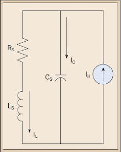

Capacitors are static or linear components, and they do not generate harmonics. However, they will interact with the electrical system source inductance and may create a parallel resonance condition at a troublesome harmonic. See Fig. 1 (click here to see Fig. 1) for a simple typical one-line diagram.

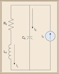

A simplified circuit model is shown in Fig. 2 (click here to see Fig. 2). Motors have high inductive impedance compared to the source impedance; therefore, we will ignore them in our circuit.
Combining transformer and electric utility source impedances is shown as RS and LS in Fig. 3. The shunt capacitance of the power factor correction capacitors is represented as CS.
In Fig. 3, the model has been rearranged for harmonic analysis and to emphasize the parallel L-C configuration with a harmonic current source.
If the circuit is resonant at a frequency in which harmonic currents are being injected by the load, circulating currents (IL & IC) will be approximately equal in magnitude and can be many times greater than the harmonic source IH.
Voltages across LS and CS can become large. This increase in current IC may cause fuses to blow, or the resulting higher voltages across the capacitors may cause the capacitor to fail or possibly rupture.
