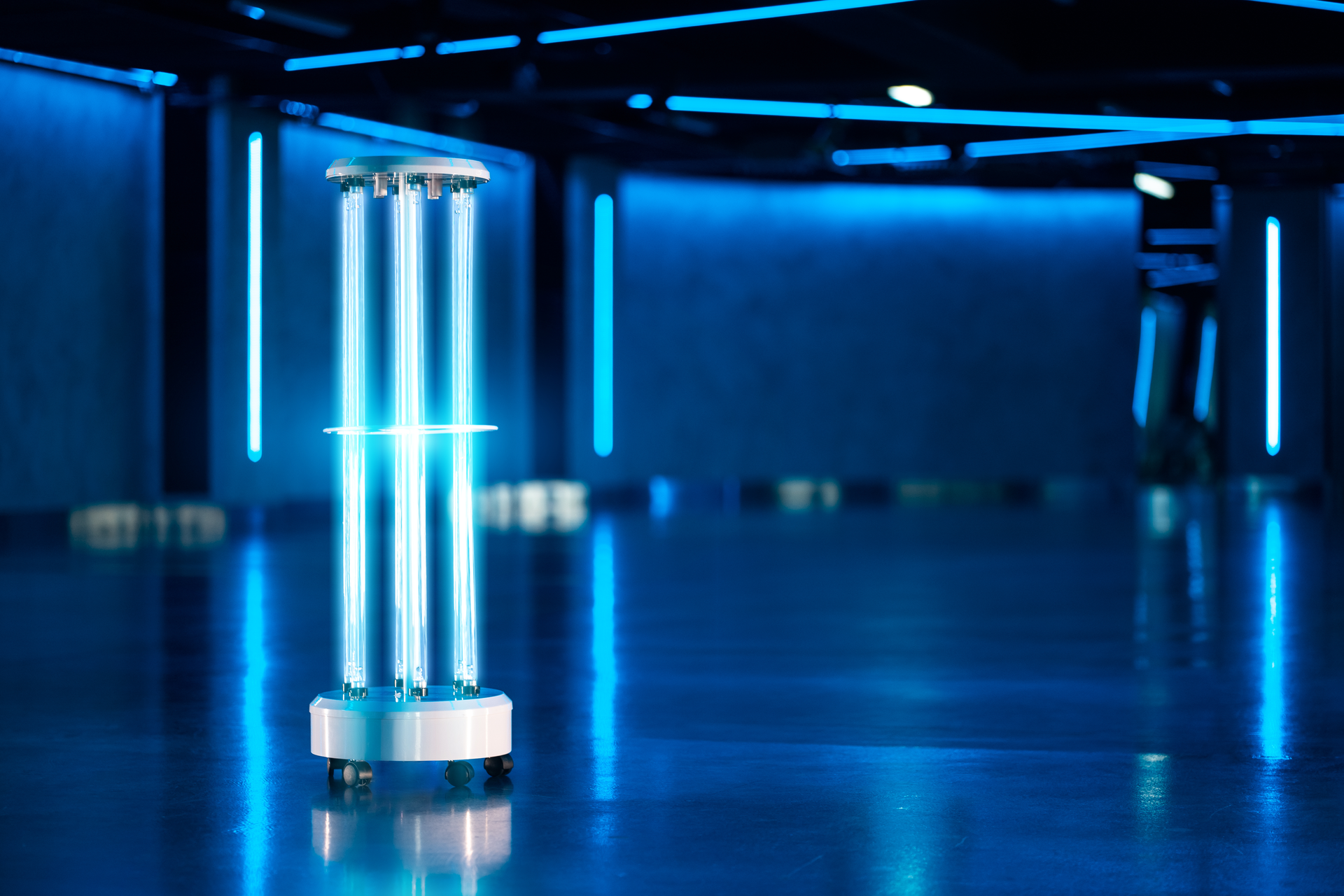

UV-C light causes chemical reactions in microbial DNA and RNA, which prevents them from reproducing and eventually kills or neutralizes the bacteria, viruses, and fungi that it encounters. UV-C is effective, but it cannot be safely used in an application where it will come into direct contact with a human being. UV-C applications include UV disinfection lamps and air purification solutions, such as upper-room UV systems and UV lighting for HVAC systems.
UV-C lighting applications are designed for applications where human beings are not present. For example, upper-room UV applications occupy the space closest to the ceiling and point upward rather than downward toward people on the ground. Additionally, surface disinfectant applications have been developed to automatically shut off when detecting movement to avoid potential human exposure.
