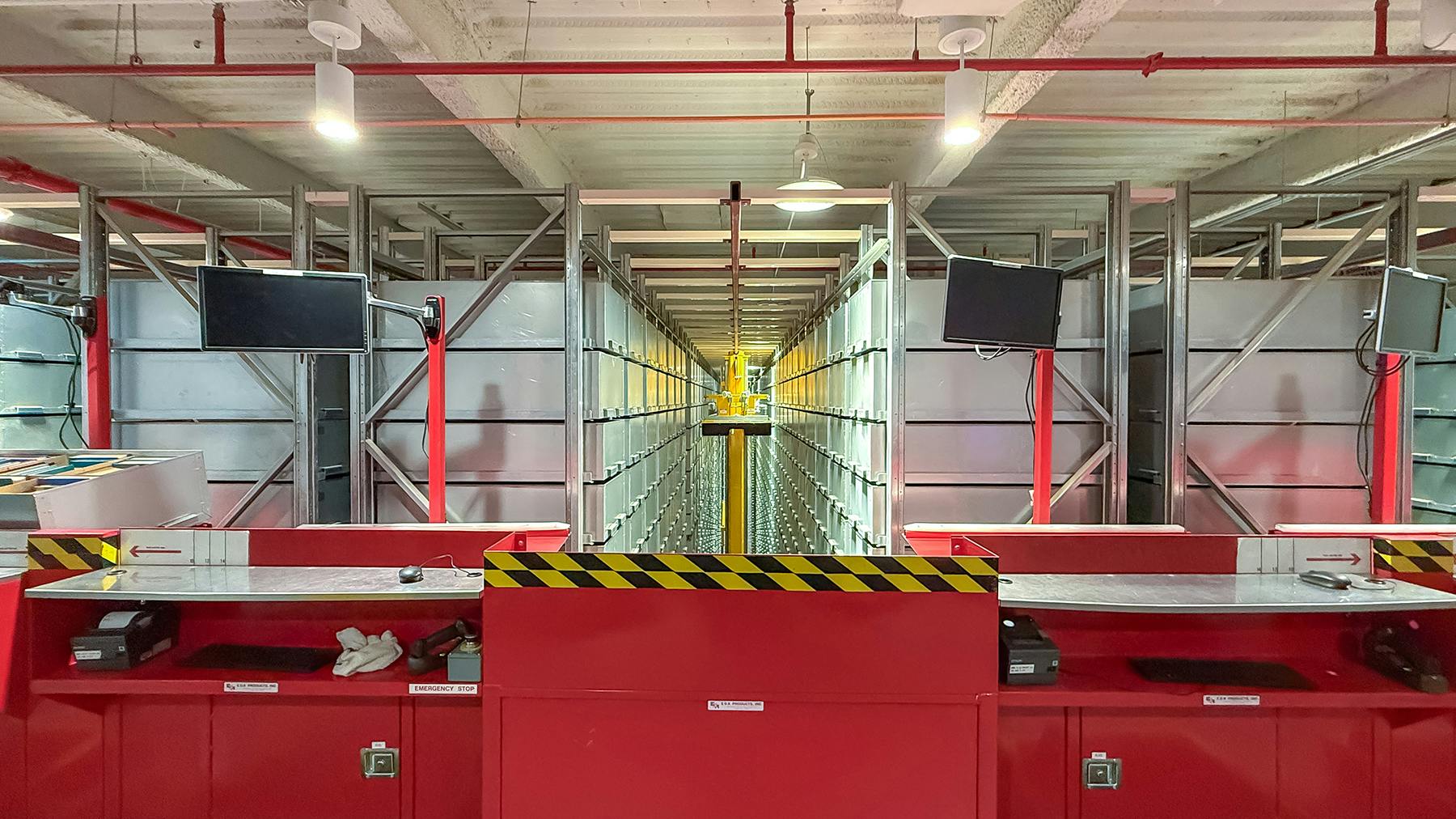

The bookBot is a group of robots and the governing software that locate, retrieve, and return items within the Hunt Library’s collection. Staff scan the items in and out of the bins, but the rest of the process is completely automated. The four robots glide down 120-foot-long aisles, using a crane and carriage arm to reach bins stacked 50 feet high.
When the center opened in 2013, the bookBot’s original lighting systems were designed not for the robots but for the humans who maintained and worked with them. It included LED cylinder downlights with integral drivers for mandated 24/7 emergency lighting, as well as fluorescent high-bay luminaires intended to operate eight hours per month for maintenance and repairs. Due to the extremely light duty cycle, no maintenance access plan was envisioned for the fluorescent work lights.
Anticipating that this innovative system would draw fascinated spectators, large viewing windows were installed at the first occupied level of the library to allow visitors and staff a peek behind the curtain. An item request feature was also installed, allowing visitors to call for an item and observe the robots at work. A third lighting system was coordinated with the robot supplier to include PAR lamps mounted on the carriages, highlighting the robots’ actions.
Unfortunately, the lighting proved insufficient to illuminate the robots at work in the vast darkness of the archive retrieval system. The library began to field questions and comments from patrons about the status of the bookBot and whether it was closed. To assuage the community’s concerns, the library staff began leaving the overhead work lights on during open hours, which exponentially increased the burn hours for the fluorescent system, resulting in the lights rapidly fading out.
Several ideas were proposed for accessing and relamping the work lights, including lifts, climbing the racking, and using the crane ladders. However, no lift existed that could navigate the aisles, and the racking system was not designed to accommodate live loads. Moreover, the ladders were not within reach of the fluorescent luminaires. As a result, not a single lamp was changed over the next decade, resulting in their dimming, discoloring, and dying. A catwalk or a coordinated ladder system could have been included in the initial design to prevent the decline in visibility for the bookBot and possibly facilitate improvements.

In 2023, Pivotal Lighting Design was tasked with studying and subsequently implementing a replacement lighting system with a longer lifecycle, along with an “archi-tainment” component to enhance the viewer experience. Execution involved shutting down the library for approximately two months to erect and remove scaffolding, change the luminaires and associated wiring, disconnect existing building controls, and install and commission a new control system dedicated to the bookBot. The resulting design was a complete replacement of the overhead lighting.
A primary design criterion for the high-bay luminaires was the ability to remotely access the LED drivers for regular maintenance. In some cases, the drivers would be located up to 200 feet away from the fixture, ganged into an array of 64 driver boxes on the wall alongside the archive storage area.
With that determination made, the general lighting was designed for overlapping coverage from the existing layout, allowing half as many lights to be in regular use, with bi-diem cycling to reduce burn time. The output was overdesigned to dim to 40%, enabling the system to ramp up the setpoint over time as the lumen output depreciates. The lifetime of the new lighting system is estimated to exceed 30 years.
Although still operational after 10 years of continuous use, the LED emergency lights were replaced to reset the lifecycle. This time, the fixtures would have remote drivers and a custom dual-board fixture that was half emergency white and half Wolfpack red. Unlike the unswitched predecessors, the new cylinder lights burn white only after hours when normal lighting is extinguished, as afforded by the UL 924-listed control bypass. The red LED boards, which are separately zoned by aisle, bathe the individual aisles in striking red when the respective robot is activated.
Traditional motion sensors and even wireless goniometers were suggested to track the robots’ movements, but the robots did not have a home base. Adhering to NCSU’s control requirements led the team to laser position sensors at the ends of each aisle to track the motion as a function of distance. Now, the light show begins whenever a robot moves as much as a meter from its position. The white lights shut off, and the red lights engage. After the robot comes to a stop, the general white lights turn back on, and the red cylinders shut off.
Adding to the sense of motion, channels of red LED tape light were added along each side of the crane ladders, directing light onto the book bins as the robot travels. Utilizing an existing beacon light relay on the robots, these 120V tape lights synchronize with the robot's activity and visually enhance its movement. Based on estimated usage, these lights have a life expectancy of over two decades; however, the tapes can be removed and replaced using the crane ladders without extraordinary measures.
