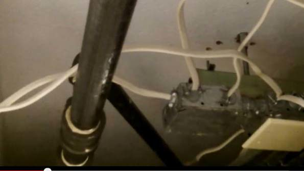

Left Hanging
What lurks in this suspended ceiling space? How about a Code violation related to the installation of these NM cables? In this episode, Russ points out the lack of support for these NM cables at this junction box location. This is a clear violation of Sec. 334.30 of the 2014 NEC.
