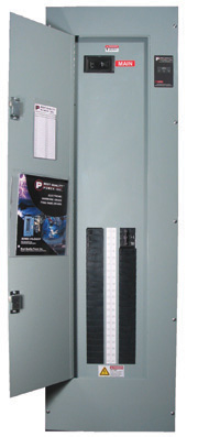

    About four years ago, Joe Arnold, president of Best Quality Power in Farmington Hills, Mich., set out to find a more practical and cost-effective way for electrical engineers to protect their clients' systems from harmonic distortion and voltage transients in a single specification. What he developed was a hybrid device within the panelboard enclosure that addressed both power quality problems. And his vision became a reality last November when he unveiled the Series 519-EHGTP (patent pending) Electronic Harmonic Grade TVSS Panelboard based on that technology at the Power Quality Exhibition and Conference in Chicago.

    Arnold says this is the industry's first, cost-effective electrical distribution panelboard to reduce current and voltage THD and to suppress damaging voltage surges/transients. The company states that in documented lab tests with single- and 3-phase nonlinear loads, the device reduced total harmonic current distortion by more than 50%. It should be noted, though, that that level of reduction is acceptable depending on the application, the site itself, and the population of nonlinear loads at the site. In addition, the panelboard includes the Sine Wave Phase Angle Tracking TVSS module, which is capable of suppressing 6,000V IEEE Category A3 ring wave transients inside the sine wave with nearly identical results — anywhere along the sine wave.
    By giving electrical engineers an answer to design and coordination issues associated with configuring consistent performance solutions to address harmonic distortion, voltage transient, and noise concerns, Arnold expects the 519-EHGTP to have an immediate and significant impact on the new construction industry. “Part of what I've learned over the years is that when it comes to power quality concerns, most people — whether they are engineers or consumers — typically go as far as wanting to make sure their equipment works reliably,” he says. “They're not looking for perfect power; they're just looking for power that makes everything work smoothly.”
