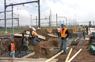

Kevco is responsible for installing duct banks and 5kV feeders, providing temporary power to the trailer complexes, and installing weatherproof lighting fixtures to illuminate the service pits and the areas above and below the track level. To upgrade and better balance the electrical system in the three existing buildings, Kevco plans to tap into the main service, upgrade the breakers, and redistribute some of the loads.
Because the facility is in operation 24 hours a day, the crew faces the danger of working in an active rail yard. Kevco requires its electricians to attend a special safety training course as well as weekly safety meetings. When the electricians are working in an area close to the track, Kevco requires flagmen to be stationed nearby to add an extra level of protection. Electricians are also advised to look both ways before crossing the tracks and be on their guard in the active areas with blind spots.
“Trains are constantly moving in and out of here,” Optof says. “Believe it or not, they can be quiet and can sneak up on you if you're not careful. Because part of the work involves construction in the yards, we're constantly crossing tracks with either personnel or with vehicles.”
Robert Stepien, project manager for E.E. Cruz and Co., says in addition to dealing with the challenge of working near the tracks, the construction team must also carefully coordinate power and utility shutdowns with the operating facility. If the workers need to dig underneath the railroad tracks, they have no more than eight hours to put the track back in service.
