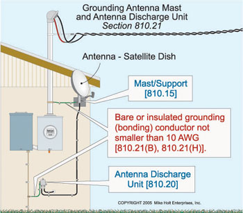

What are the NEC grounding requirements for a satellite dish?
Q. What are the NEC grounding requirements for a satellite dish?
A. The metal mast [810.15] for radio and television equipment and its lead-in cable via a discharge unit [810.20] must be grounded to the building grounding electrode system in accordance with the requirements of 810.21.
