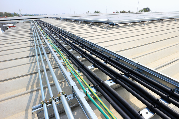

Question: What minimum clearance above a roof is required for a raceway exposed to direct sunlight to avoid the application of additional temperature correction adjustments?
See the answer below.
Answer: 7/8 in.
Explanation: Section 310.15(B)(3)(C) requires an adder of 60°F to be added to the design temperature for ampacity correction purposes for a raceway exposed to direct sunlight on a roof when the clearance above the roof is less than 7/8 in.
