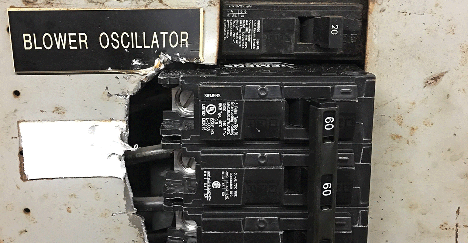

“We obviously didn’t do it. Done by in-house maintenance. Breaker feeds blower in the tunnel. Correct amperage, wrong style.” That was the quote I received from the electrician who sent me this photo. I don’t blame him for wanting to remain anonymous after discovering this mess at a car wash in Massachusetts. It looks like “Hack-n-Smash” Electric Co. may have been in a rush to get it done. They may have gotten the power on, but boy did they create a real mess and a few NEC violations in the process.
Installing a breaker that was obviously way too big and not designed for this enclosure violates the installation and use requirements of Sec. 110.3(B). With the metal cover cut away so much, it leaves the energized terminals of the circuit breaker exposed and at risk of be contacted. Section 110.27(A) requires these live parts to be guarded against accidental contact by being installed in an approved enclosure.
The circuit breaker blanks missing at the top have also created a shock hazard by leaving the bus bars exposed. Section 408.7 requires any unused openings for circuit breakers to be closed with identified circuit breaker closures or circuit breaker blanks.
