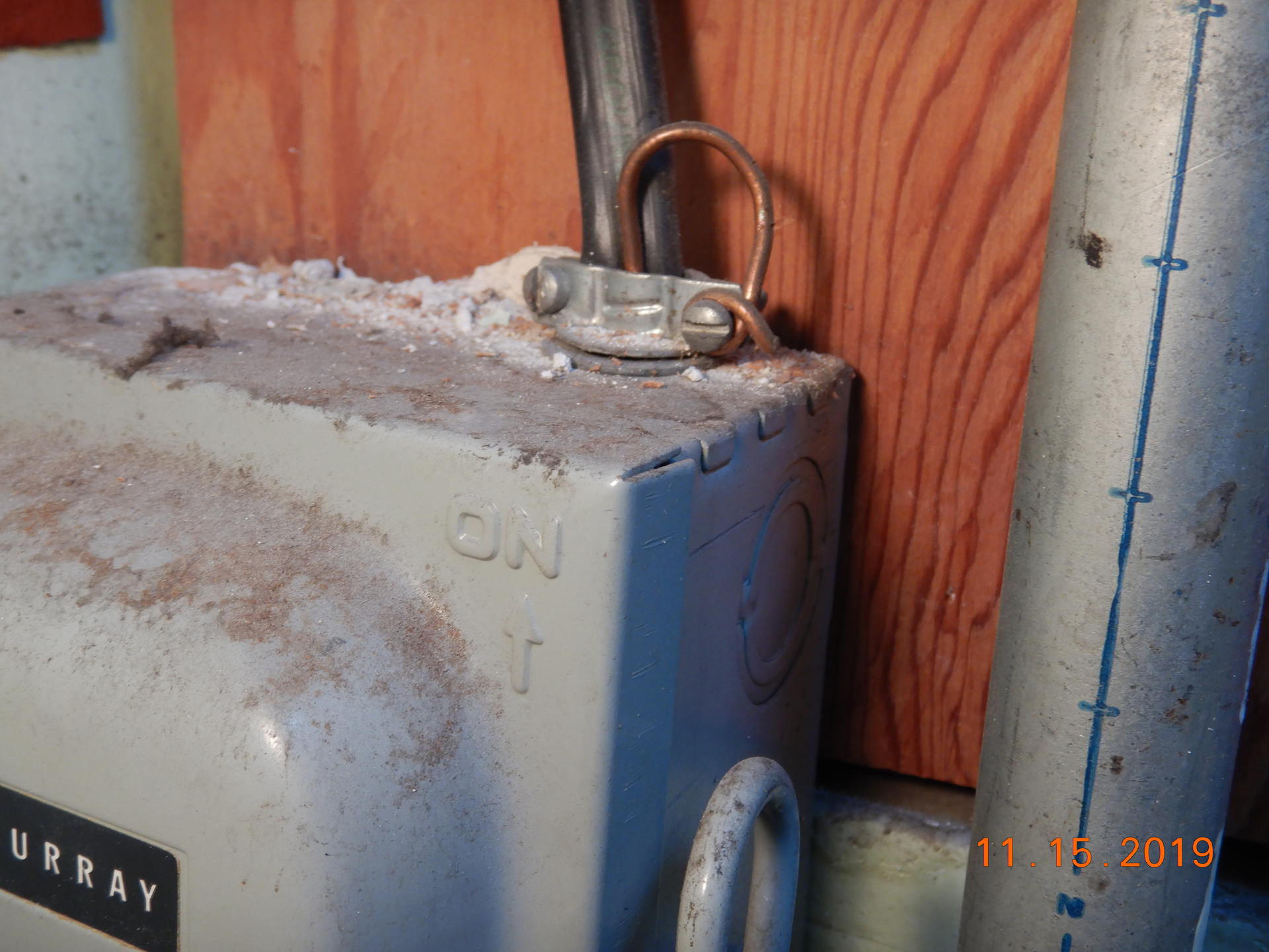

Double Duty Connector
Using the clamp screw of an NM cable connector for terminating the equipment grounding conductor (EGC) is a violation of Sec. 250.8. EGCs, grounding electrode conductors (GECs), and bonding jumpers are permitted to be connected by listed pressure connectors such as twist-on wire connectors, terminal bars, pressure connectors listed for grounding and bonding, exothermic welding, machine screw fasteners that engage at least two threads or are secured with a nut, thread-forming machine screws engaging at least two threads into the enclosure, connections made as part of a listed assembly, or other listed means. Using an NM cable connector for connecting an EGC is not one of the eight permitted means specified in Sec. 250.8. This installation probably does not comply with Sec. 250.12 either because the paint was not scraped off the surface of the enclosure to ensure electrical continuity between the connector and enclosure. The NM cable connector may be listed for securing NM cables, but I’m sure it is not listed for grounding and bonding purposes. As such, this would be a violation of Sec. 110.3(B) as well.
