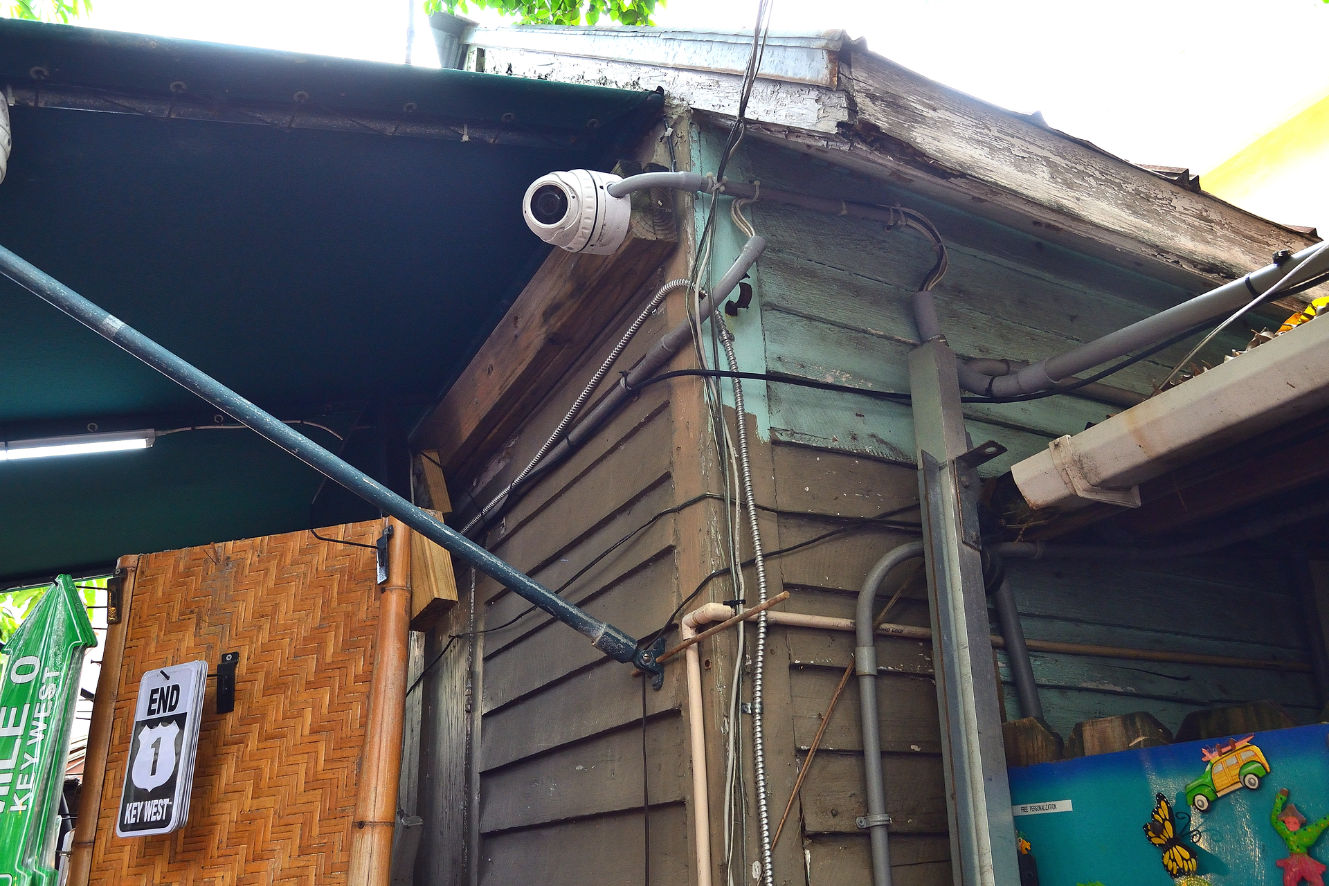

I spotted these violations on the backside of some Key West, Fla., shops. The wrong type of MC cable was used here. Installing MC cable in wet locations such as this is permitted by Sec. 330.10(A)(11), but only when a corrosion-resistant jacket is covering the metal covering and any one of the following three conditions are met: the metal covering is impervious to moisture, a moisture-resistant jacket is provided under the metal covering, or the insulated conductors under the metal covering are listed for use in wet locations. These MC cables look like typical MC cables that would be used for wiring offices or other commercial spaces. They’re not suitable for this outdoor wet location. Securing cables to the exterior of rigid PVC conduit as a means of support for cables violates the requirements in Sec. 300.11(C). The black cable ties are most likely UV resistant or sunlight resistant, but the white cable ties are typically not identified for use in sunlight and would not comply with Sec. 300.6(C)(1). In my experience, cable ties that are not sunlight resistant generally will become brittle and fail rather quickly when installed in areas exposed to sunlight.
