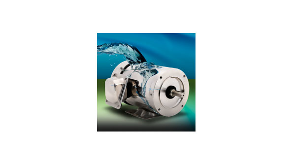

  Stainless steel 3-phase motors have been added to the IronHorse product line
The IronHorse general-purpose AC motor line now includes stainless steel
3-phase motors offered in ranges from 0.33 hp to 2 hp. Available in speeds of 1,800 rpm and 3,600 rpm, the motors are electrically reversible and feature 304 stainless steel frames and stainless steel shafts. The IP56-rated products are equipped with a large easy-to-wire junction box with fluorinated silicone rubber gasket and a stainless steel cable gland. In addition, NEMA design B motors are available with or without mounting feet and can be mounted in any orientation, horizontal or vertical, as long as the drain plugs are installed in the two lower locations. The stainless steel series is CSA-certified, and is designed for washdown
