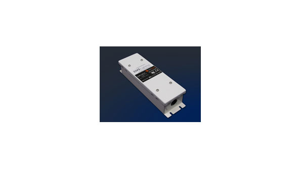

Available with power from 28W to 200W, the SLD, XLD, and XLA Series of LED drivers feature an easy-to-install wiring compartment and work with a range of dimmer switches.
The SLD, XLD, and XLA Series of LED drivers are available with power from 18W to 200W.
The XLD and SLD models are UL-listed and feature an easy-to-install wiring compartment that eliminates the need for a J-box. These drivers operate over a temperature range of -40°C to 60°C without de-rating and are available with IP65 option for operation in wet outdoor applications. The XLA Series offers smooth and flicker-free AC line dimming. This model features 90VAC to 132VAC input or a 180VAC to 264VAC input option. Tested to work with a range of TRIAC and ELV dimmer switches, these drivers dim to full off, are Energy Star/CEC compliant, and meet UL, cUL, CE, CB, and FCC Class B regulatory requirements.
