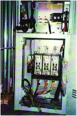

Photo 1. The open electric cabinet with three phase conductors feeding in from the floor. Plastic acrylic block is opened to expose three fuses limited to 125A per phase. Left of fuses is the clock wire that bypasses the safety interlock. In the top of the picture is the beginning electronics of the VFD.

On the morning of the accident, the technician checked into the facility and continued working on the system, just as he’d done every day for the past week (Photo 1). A few hours later, an employee found him lying unconscious on the floor close to the panel in front of the circuit he was working on with tools next to him. The employee immediately called for emergency personnel. Upon arrival, paramedics pronounced the victim dead at the scene.

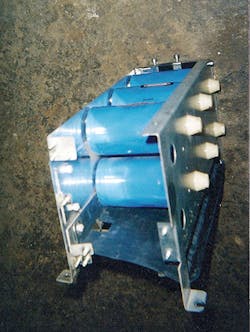

Photo 2. Capacitor bank lies on floor next to open electric cabinet. “Hot” lead of each capacitor is protected by a plastic cap (on top of the aluminum metal housing). “Cold” lead of each cap is tied to aluminum housing as a chassis ground.
Another important observation related to the large metal frame (approximately 6 in. × 6 in. × 2 ft), which contained a bank of capacitors charged to 500V and was sitting on the floor next to the VFD. It had obviously been un-screwed from the rack that held the VFD (Photo 2). Following the accident, the factory’s full-time electrician immediately opened the main breaker, which was still energized, and pulled out two fuses to deactivate the panel the technician had been working on. At that point, he also notified OSHA of the accident.

Based on the investigation, we gathered many facts relating to the electrical arrangement that helped reconstruct possible scenarios leading up to the accident. Coming up from the floor at the electric cabinet was a large diameter conduit that contained four wires — one grounded conductor and three ungrounded conductors. The circuit was rated 480V and connected in a 3-phase star arrangement. The ungrounded conductors were connected to a terminal strip block at the bottom of the cabinet. The entire block was covered with a large acrylic plastic block, and the door was designed with an automatic shutoff.
The top of the terminal block was easily accessible, but it was automatically disconnected when the door opened. Although the bottom of the terminal strip remained live at all times, to reach it, a person would have had to kneel on the floor and reach under the plastic in a fashion most people would find extremely awkward or even impossible.
The capacitor bank consisted of a metal base upon which six electrolytic capacitors (rated at 500V and 15,000 mF) were found. All capacitors had one lead tied to the metal base. Therefore, the base was a “chassis” ground, which is designed to be mounted on the metal rack with screws. When it is screwed in place, the chassis ground becomes an earth ground because the rack has a direct connection to earth.
The electric cabinet supplied a VFD connected to a very large 75-hp motor. The VFD required a clock to synchronize its output frequency (i.e., chopping frequency). The clock required a trivial amount of current to operate. The frequency of choice by the manufacturer is 60 Hz, since this is readily available from the line voltage found in most U.S. electrical systems. Using 60 Hz as a standard, many other frequencies can be generated via routine logic circuits.
From the output power of the 3-phase circuit, a single thin wire ran from one of the phases (where it made electrical contact) through a limiting resistor and to the clock. Because each phase supplied 125A — and the draw from the clock chip was limited to 25mA — there was no concern about mismatching the one phase relative to the other two. In fact, to ensure stability, a wire was run by the company electrician from the point where the input conduit came in from the floor beneath the electric cabinet. The wire tied into one of the three phases, and then went directly through the limiter and to the clock chip.

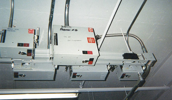

Photo 3. This overhead safety switch is connected to the VFD. It is located too far away to be of any advantage in this accident.
A lockout/tagout procedure governs the electric cabinet. Overhead (on the ceiling) was a disconnect that could limit all power to the electric cabinet as well as the VFD and motor (Photo 3). The problem was this disconnect was located 25 ft away from the VFD control rack and accessible only by a ladder or pole. However, if the overhead disconnect was ON and someone opened the electric cabinet’s door, then the input power from the conductor running through the conduit at the bottom of the cabinet was cut off from reaching the top of the cabinet. This feature is an automatic shutoff built into the VFD by the manufacturer.

Was it the capacitor bank?
It is significant that the only thing the technician removed from the electric cabinet before he died was the capacitor bank, which was sitting on the floor next to him. If the capacitor bank killed the victim, then the electric current would not be constant — it would be diminishing in an exponential fashion. Yet, if it remained large enough for a long enough period of time, it could be the cause of death.
The capacitor bank was actually a prime suspect. Assuming a human to have approximately 1,000 ohms of resistance, the peak current would be 500mA. But when a resistance is attached to a capacitor, the current drawn decays to zero over time. However, was the current enough to kill the technician during the time he held it? Also, would it kill via VFIB or asphyxiation? We answered this question based on evidence from the scene.
If the technician were holding the capacitor bank when it began to jolt him, he would fall, which would break the circuit. There was no evident damage to the capacitor bank’s frame from it being dropped, and all capacitors appeared to be close to fully charged when we measured the voltage across each. Similarly, if the bank was resting on the floor — and if the technician bent over and touched one of the hot leads — he would also have to touch the metal base with his other hand (not a very likely scenario). So, even if the capacitor bank could have killed the technician, the ancillary evidence did not support this theory as the mode of death. Therefore, we concluded the capacitor bank did not kill the technician.

Was it the VFD clock wiring?
As noted earlier, a grey fuse box was powered even when the VFD disconnect was in the OFF position. Furthermore, there was still one wire leaving the grey fuse box and traveling up to service a portion of the VFD (i.e., the clock circuit). The important thing is that the VFD (or a portion of it) was powered even when the VFD was supposed to be de-energized due to the disconnect being in the OFF position. Furthermore, the VFD was powered in a fashion that would moderate the levels of current to those low values enough to cause asphyxia and cyanosis. The actual components that reduced the current flow are many, but the primary ones are: the fuses, control relays, control transformer, and circuit board controlling the VFD. The current from this “hot” wire was limited to 25mA, according to tests by multiple investigators in this case.
The grey fuse box bypassed the safety feature of the VFD-disconnect. Power was supplied to the VFD clock even when the disconnect shut the main power off.
The grey box was current limited to 25mA, which is sufficient to exceed the let-go current and kill via asphyxiation. Hence, we concluded that it was the only thing that could have killed the technician.
Ironically, the part of the VFD setup that had the lowest current and power killed the victim. It had not been subjected to the scrutiny reserved for the high power components. It did not have a lock-out, tag-out protocol that an ordinary technician could use. There was a master disconnect to the VFD, but it was on the ceiling 25 ft away.
The disconnect (on the ceiling) was placed into the OFF position the previous day — the company electrician did this in front of the technician. To do this, the electrician obtained a ladder and climbed up to reach the switch. The next morning, the electrician re-energized the circuit by turning this switch back on before the technician arrived as a favor to help him get a quick start on testing. Apparently, the electrician also had to run off and do other important jobs at the company, and could not wait for the technician that morning.
