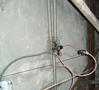

Here’s your chance to moonlight as an electrical inspector and second-guess someone else’s work from the safety of your living room or office. Can you identify the Code violation(s) in this photo?
Hint: Growing out of control

Our three winners this month were: Paul Furman, owner of PDF Electric, Pawcatuck, Conn.; Timothy Waldman, electrical code official for the city of Reading, Reading, Pa.; and Mark Sheehan, estimator for JH Electrical Enterprises, Poughkeepsie, N.Y. Here's just a few of the many Code violations these three associated with this mess of a residential service panel.
  • Installation is not neat and workmanlike [110.12].
  • Improper electrical connections and terminations (i.e., more than one wire terminated on branch and main breakers) [110.14].
  • Improper identification of grounded and ungrounded conductors (i.e., white wire being used as ungrounded conductor and red wire being used as grounded conductor) [200.6, 200.7 and 210.5].
  • Undersized conductors attached to main breaker (i.e., not properly protected) [240.4].
  • Enclosures for switches and overcurrent devices shall not be used as junction boxes [312.8].
