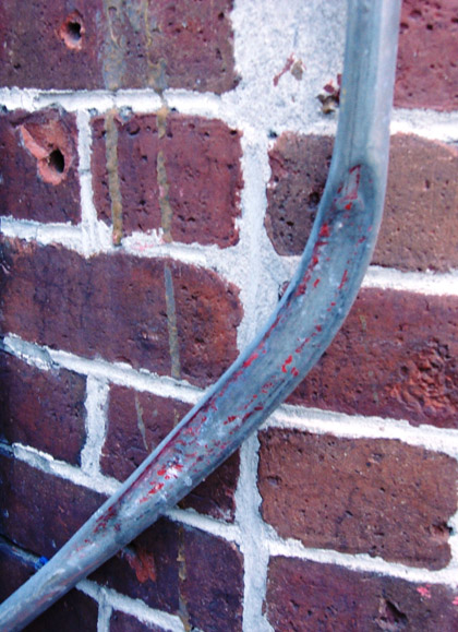

Hint: Bad bend or lack of protection?
Find the Answer
Answer:
As noted in 300.4 (Protection Against Physical Damage) of the 2005 NEC, “Where subject to physical damage, conductors shall be protected.”
It looks as if this “pancaked” conduit was backed into by a delivery vehicle. The conduit contains energized conductors, most likely supplied from the space below to serve the upper floors. As you know, fishing in wire in older buildings, especially those made of brick, is not possible.
However, I could find no reference in Art. 342 or 344 that requires any special or additional protection be provided in this type of installation because these wiring methods are supposed to be used in areas subjected to physical damage [300.5(D)]. So I would have to say that in this case it was not the fault of the installer, but the fact that this driveway is used every day for deliveries to a hotel kitchen's back door.
