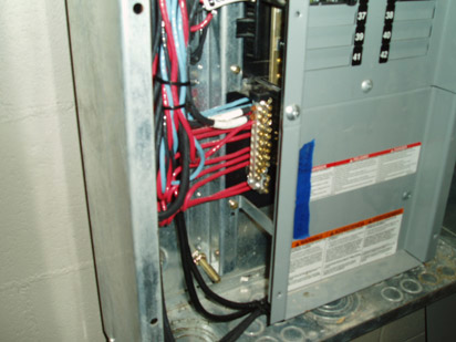

Hint: Was this installer color blind?
Find the Answer
One picture shows two black conductors marked with white tape terminated on a grounded conductor (neutral) bar. Red and blue conductors are then used as branch circuit neutrals. The other picture shows a single black conductor with green tape terminated on the equipment grounding terminal bar. Blue conductors are then used as grounds. This work was found inside a 120/240V single-phase panel.
As per the conductor identification requirements of 310.12, “(A) Grounded Conductors. Insulated or covered grounded conductors shall be identified in accordance with 200.6. “(B) Equipment Grounding Conductors. Equipment grounding conductors shall be in accordance with 250.119. “(C) Ungrounded Conductors. Conductors that are intended for use as ungrounded conductors, whether used as a single conductor or in multiconductor cables, shall be finished to be clearly distinguishable from grounded and grounding conductors. Distinguishing markings shall not conflict in any manner with the surface markings required by 310.11(B)(1). Branch circuit ungrounded conductors shall be identified in accordance with 210.5(C). Feeders shall be identified in accordance with 215.12. “Exception: Conductor identification shall be permitted in accordance with 200.7.”
