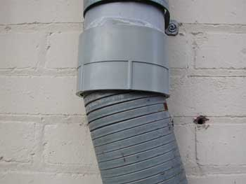

Hint: Sing along with me. One of these things, doesn’t belong here
Answer:
The wiring methods used in this connection are not compatible. As per 300.15 of the 2005 NEC, fittings and connectors shall be used only with the specific wiring methods for which they are designed and listed. Therefore, this installation violates the requirements of the Code.
