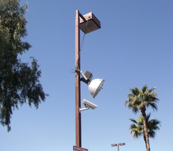

Joe Guarino, products standards engineer, Cooper Lighting, Peachtree City, Ga., correctly noted that the luminaire at the top of the pole is supplying power to the sports luminaire, which is a clear violation of 110.3(B) of the 2002 NEC. The pole-top ...
Find the Answer
Joe Guarino, products standards engineer, Cooper Lighting, Peachtree City, Ga., correctly noted that the luminaire at the top of the pole is supplying power to the sports luminaire, which is a clear violation of 110.3(B) of the 2002 NEC. The pole-top luminaire was never designed for this purpose.
In addition, Tony Milosevich, system integrator, Superior Alarm Systems, Van Nuys, Calif., and Ray Sanderson, electrical supervisor, Teknor Apex Carolina Co., Fountain Inn, S.C., noted that per 725.55(A) through (J), CCTV camera wiring (Class 3, Type CM) can't share raceway with lighting and power circuits. Anderson also noted that the lighting equipment isn't weatherproof, and that this connection isn't an NEC-recognized installation method.
