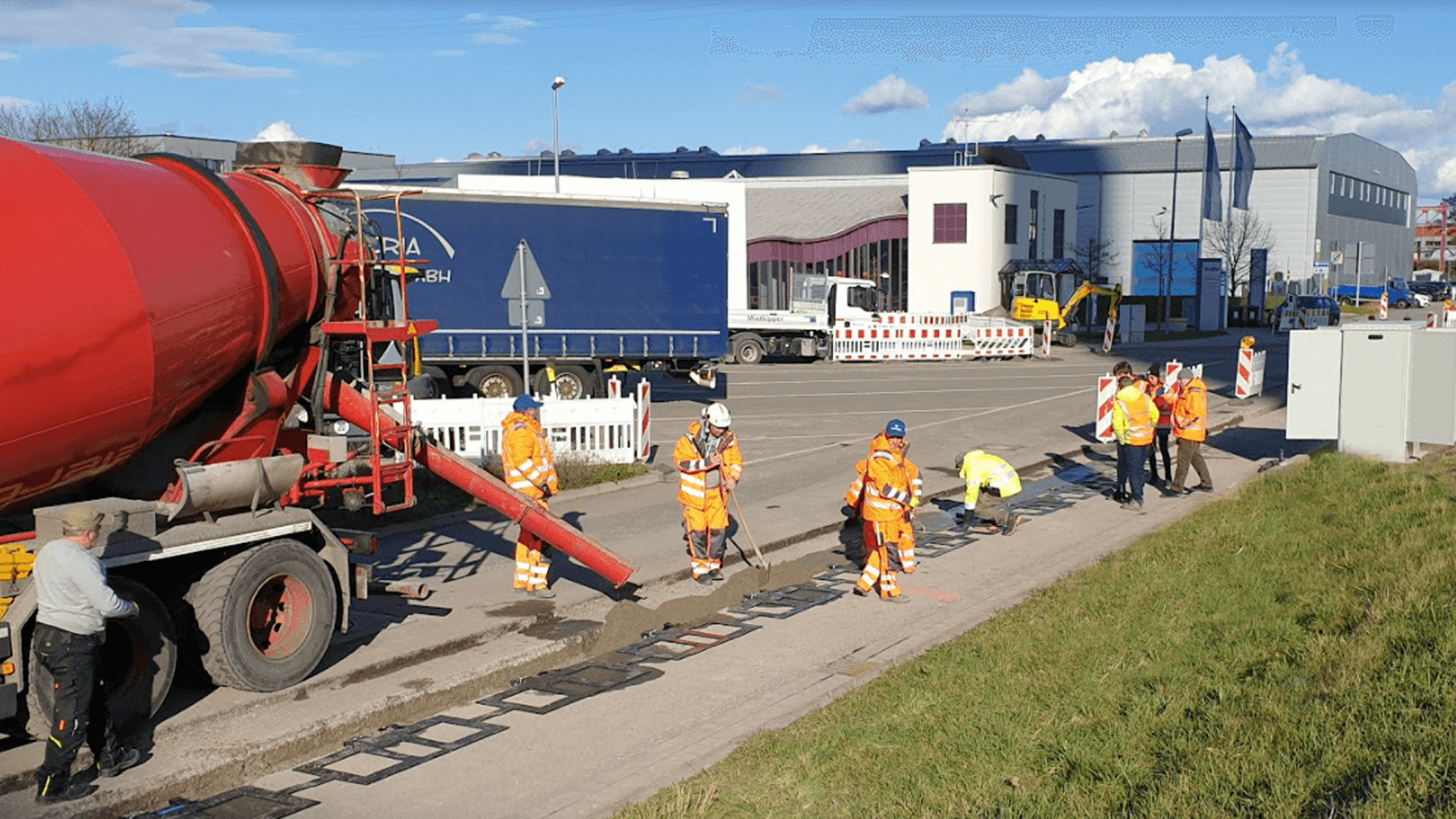

The state announced on February 1 it was giving an Israeli company that has been testing the concept overseas, Electreon, a $1.9-million contract to build a mile-long section of public road in Detroit that will enable inductive vehicle battery charging. The magnetic resonance induction technology used puts copper coils under the roadway surface, which takes power from the grid through ground assemblies. That energy is then transmitted to an undercarriage receiver and onto a vehicle’s battery, enabling both dynamic charging as the vehicle moves or semi-dynamic charging of a parked vehicle via charging stations.
Electreon and its partners, including Dallas-based Jacobs Engineering Group, Michigan utility DTE Energy, and Detroit-based Next Energy, will design and build the road in Michigan Central, a visionary re-development project near downtown Detroit that includes a transportation-focused “mobility innovation district.” Ford Motor Co. is spearheading the project assisted by the Michigan Department of Transportation and the Michigan Office of Future Mobility and Electrification and other public-private entities. The project’s timeline calls for the road to be operational and open to utilization and testing by potential stakeholders sometime in 2023.
