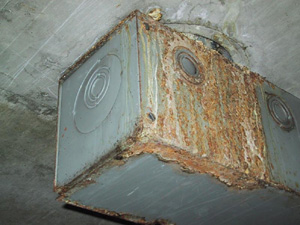

Rusty Wireway
A metal wireway is a sheet metal trough with a hinged or removable cover used for housing and protecting electric wires and cable. Typically, the conductors are laid in place after the wireway has been installed as a complete system (376.2). The Code doesn't permit you to locate wireways where they're subjected to severe physical damage or severe corrosive environments [376.12(1) and (2)].
This installation was discovered near Baltimore's Inner Harbor in a downtown parking structure. Almost all of the exposed wiring methods located on the ceiling at street level were found in this condition. The local environmental conditions probably caused the corrosion. All materials are required to be suitable for the environment in which they're to be installed. See 300.6 for rules concerning protection against corrosion.
