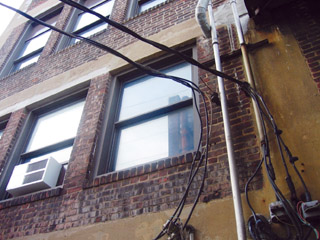

This service drop and service entrance conductors are positioned much too close to this window. As per 230.9, “service conductors and final spans shall comply with 230.9(A), (B), and (C).”
The requirements of 230.9(A) state when service conductors are installed as open conductors or in a multiconductor cable without an overall outer jacket they're required to have a clearance of no less than 900 mm (3 feet) from windows that are designed to be opened. This same requirement pertains to doors, porches, balconies, ladders, stairs, fire escapes, or similar locations. An exception to this rule allows you to run the conductors above the top level of a window and exempts you from meeting the 900 mm minimum separation requirement noted above.
