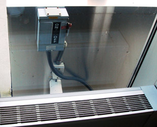

THROUGH THE LOOKING GLASS
I found this installation in a major U.S. airport. The disconnect for this equipment is visible, but is not readily accessible because it's located behind a window. The following Code section applies to this installation.
“440.14 Location. Disconnecting means shall be located within sight from and readily accessible from the air-conditioning or refrigerating equipment. The disconnecting means shall be permitted to be installed on or within the air-conditioning or refrigerating equipment.
“The disconnecting means shall not be located on panels that are designed to allow access to the air-conditioning or refrigeration equipment.
“Exception No. 1: Where the disconnecting means provided in accordance with 430.102(A) is capable of being locked in the open position, and the refrigerating or air-conditioning equipment is essential to an industrial process in a facility with written safety procedures, and where the conditions of maintenance and supervision ensure that only qualified persons service the equipment, a disconnecting means within sight from the equipment shall not be required. The provision for locking or adding a lock to the disconnecting means shall be permanently installed on or at the switch or circuit breaker used as the disconnecting means.”
