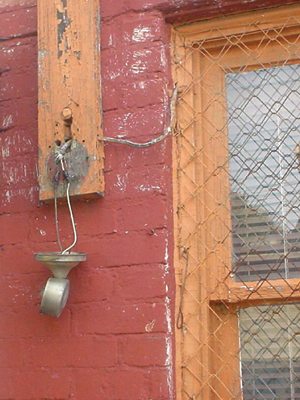

A SHINING EXAMPLE OF POOR WORK
Not only is this installation missing an outdoor box required by 300.15, but it also uses an incorrect type of cable assembly for this particular location. Any luminaire (fixture) installed in a wet location must be installed so that water can't enter or accumulate in wiring compartments, lampholders, or other electrical parts. In addition, all luminaires installed in wet locations must be marked “Suitable for Wet Locations,” per 410.4(A), Luminaires (Fixtures) in Specific Locations, Wet and Damp Locations.
