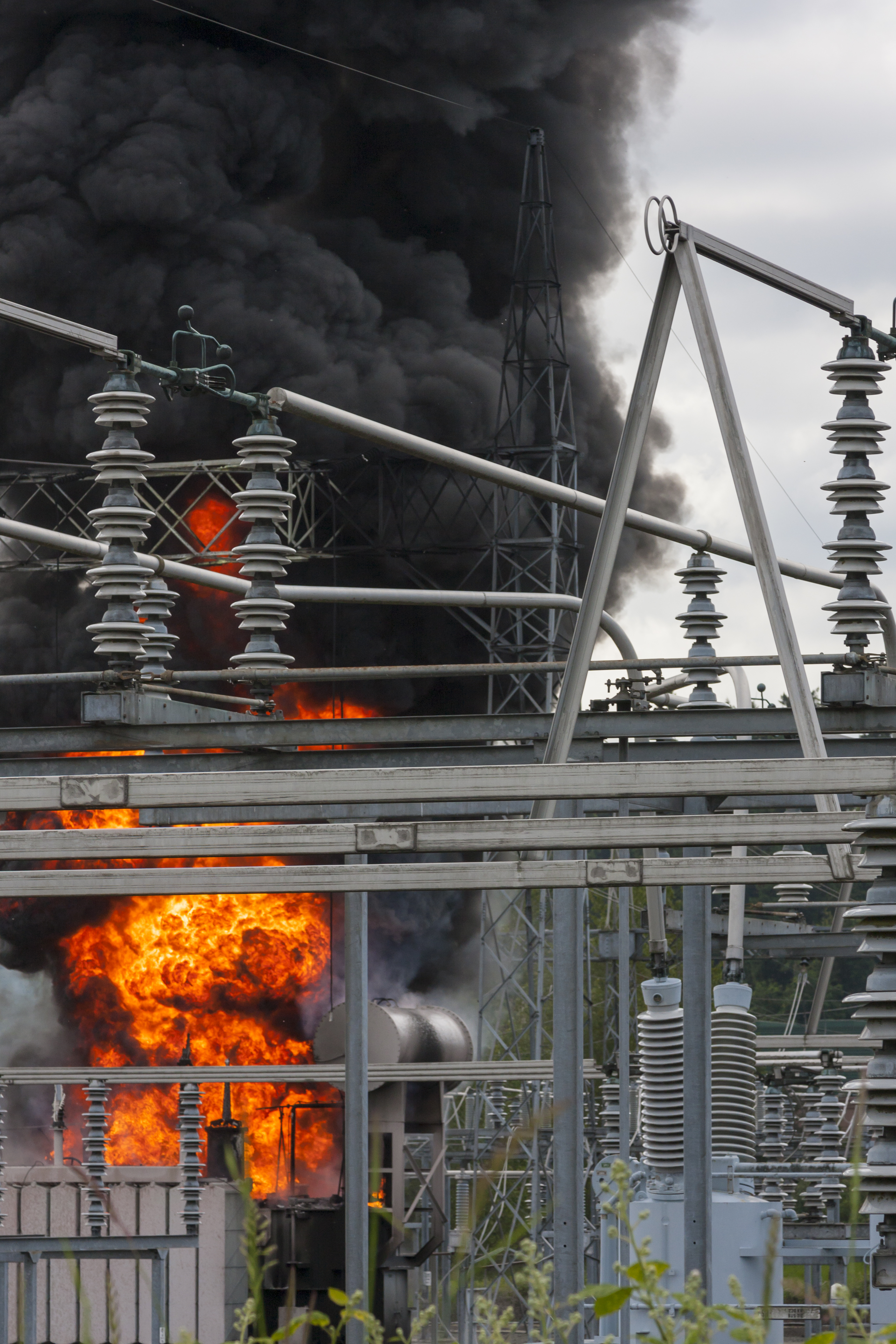

According to a press release from American Transmission Co. (ATC), the electric utility continues to provide information on the recent substation fires in Madison, Wis., including the latest investigation findings, environmental cleanup efforts, and when a new transformer will be operational. As background, an ATC transformer caught fire at Madison Gas & Electric’s Blount Street Substation at 7:39 a.m. on Friday, July 19. A few minutes later, a second fire occurred at the East Campus Substation. The two substations are electrically connected by underground cables. Both fires were extinguished by approximately 9 a.m.
ATC investigated the cause of the transformer fire with the help of the Electric Power Research Institute. Together, ATC and EPRI performed a visual inspection of the damaged transformer at Blount Substation a few days after the fire and then conducted a controlled teardown of the transformer to disassemble and inspect the condition of various components to better understand the cause.
As previously shared, prior to the fire, ATC had been closely monitoring a component on the Blount transformer because of observed anomalies. ATC consulted with the component manufacturer, conducted additional inspections July 15, 16, and 17 — and made plans to take the transformer out of service for a detailed internal inspection on July 22.
“Based on our experience and consultation with the manufacturer, we took prudent action in scheduling the outage,” said Jim Vespalec, ATC director of asset planning and engineering. “While the transformer suffered considerable damage in the fire, the inspection and teardown showed that the failure originated in the voltage regulating component due to mechanical failure, generating combustible gases and resulting in a fire.”
