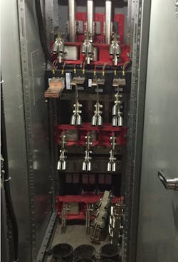

Most low-voltage work on energized panelboards (Photo 1), switchboards, motor control centers (MCCs), or switches would be considered inside an enclosure (VCB, VCBB, or HCB). An example of an open-air installation would be pole-mounted overhead conductors.
It is possible to encounter different conductor configurations within the same equipment, depending on the work task. IEEE 1584-2018 Annex C provides some guidance on the selection of conductor configuration. For example, within a MCC, the electrode configuration could be VCB or VCBB, depending on the fault location. For low-voltage draw-out switchgear, a fault on the bus studs with a breaker racked out may correspond to the HCB mode (Photo 2).
Much higher incident energy may be predicted by the 1584-2018 calculations using the HCB conductor configuration compared to the 1584-2002 calculations — all else being equal. This is based on experiments that indicate horizontal electrodes direct more of the heat toward the open front of the enclosure than vertical electrodes. Therefore, facilities that regularly perform “hot work” on switchgear or switchboard systems (such as racking in drawout breakers on a hot bus) may want to consider updating their arc flash studies, since it is possible that incident energy is presently under-represented.

For the 2018 model, conductor configuration had to be selected for each bus. Based on the guidance of Annex C, the VCBB configuration was initially selected for all MCCs, panelboards, enclosed circuit breakers, and disconnects. Further study found the VCBB electrode configuration to result in higher incident energy for all but five panelboards. For these panelboards, the VCB configuration resulted in a lower arcing current and longer interrupting time, producing a higher incident energy than the VCBB configuration. Per Annex C, certain faults within a panelboard are consistent with VCB, so VCB was selected for these five buses. For the MCCs, the VCBB configuration resulted in higher incident energy than VCB, so VCBB was selected.
Since certain faults in switchgear or switchboard draw-out compartments correspond to the HCB configuration, HCB was selected for the service main compartment. This resulted in an incident energy that was 40% higher than that calculated from the 2002 method. The incident energy was also twice what was calculated assuming the conductors were in the VCB configuration, which indicates the importance of selecting an appropriate configuration.
