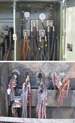

The most significant safety issue in the electrical industry is the threat of electrical workers being injured or killed by arcs and blasts. The principal hazards associated with such arcs and blasts include thermal burn injuries and physical trauma from the blast concussion and flying projectiles caused by partially melted components being propelled by the force of the blast. Therefore, it’s important to understand that the focus of arc flash hazard analysis (AFHA) is to mitigate hazards — not merely to select flame-resistant (FR) clothing.
Many electrical engineers have used the methodologies discussed in this article to calculate the “heat” associated with electric arcs, but then used that information only to recommend electrical workers wear higher levels of FR clothing when performing energized work. The appropriate approach would be to first exhaust reasonable attempts to make engineering changes to the system to reduce the “heat,” and then select the appropriate FR clothing for the risk that cannot be adequately controlled through engineering interventions. Let’s take a closer look at the AFHA process and examine what factors electrical engineers should consider when attempting to protect electrical workers in the workplace.
