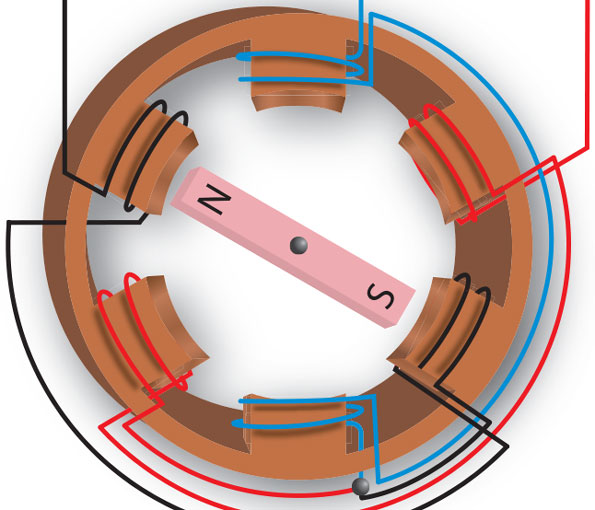

    A 3-phase generator (internally configured wye).

    Gen-sets are mechanical devices comprised of an engine turning the shaft of a generator, which generates power to supply a load. The generator is always rated in kW with a power factor of 80%.  All generators are considered to be rated at 80% power factor unless the nameplate states differently. The rating of a generator requires the load to be examined with respect to kW (i.e., true power). This approach allows the electrician to accurately size the generator.
    For example, say a generator is to serve a building made up of several different types of loads: lighting panels for resistive lighting (higher power factor), lighting panels for fluorescent lighting (lower power factor), power panels feeding HVAC equipment with motors (poor power factor), receptacle panels feeding general office equipment (lower power factor), and so on. As you can see, the building’s power factor is difficult to calculate at any one time. If a generator was rated at 100kVA and the total building load was 100kW, the building power factor of 80% would create a 125kVA load. This generator would be undersized for the load. By rating the generator at 100kW with an assumed 80% power factor, the chance of incorrectly sizing a gen-set is lower. Unlike a transformer, which is providing power by means of mutual inductance, a generator is directly coupled to an engine.  A load larger than the generator’s maximum kW rating will physically load the engine so that it can’t deliver the hp required by the generator.
    The kVA rating of a generator can be calculated by dividing the kW by the power factor (kVA = kW ÷ 0.8). But as mentioned above, the tendency to use the calculated kVA of a generator oftentimes results in an undersized generator for the load served.
