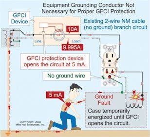

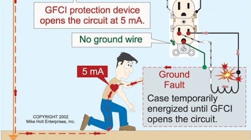

You may know in what situations the NEC requires you to install a ground-fault circuit interrupter (GFCI), but do you know how it works? A GFCI is specifically designed to protect people against electric shock from an electrical system, and it monitors the imbalance of current between the ungrounded (hot) and grounded (neutral) conductor of a given circuit. Don't let the name confuse you — these devices will operate on a circuit that does not have an equipment-grounding conductor.
With the exception of small amounts of leakage, the current returning to the power supply in a typical 2-wire circuit will be equal to the current leaving the power supply. If the difference between the current leaving and returning through the current transformer of the GFCI exceeds 5mA, the solid-state circuitry opens the switching contacts and de-energizes the circuit.
However, a GFCI doesn't give you a license to be careless. Severe electric shock or death can occur if you touch the hot and neutral conductors in a GFCI-protected circuit at the same time because the current transformer within the protection device won't sense an imbalance between the departing and returning current and the switching contacts will remain closed.
