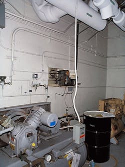

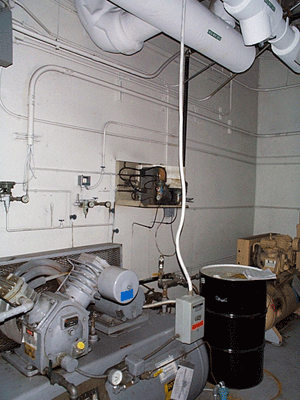

The branch circuit conductors for this compressor were supplied through this liquidtight flexible metal conduit (LFMC), and the raceway shows no sign of any support. Sec. 350.30(A) requires you to securely fasten LFMC in place and support it by an approved means within 12 in. of each box, cabinet, conduit body, or other conduit termination. It must also be supported and secured at intervals greater
Aug. 15, 2002
The branch circuit conductors for this compressor were supplied through this liquidtight flexible metal conduit (LFMC), and the raceway shows no sign of any support. Sec. 350.30(A) requires you to securely fasten LFMC in place and support it by an approved means within 12 in. of each box, cabinet, conduit body, or other conduit termination. It must also be supported and secured at intervals greater than 4-1/2 ft. Supports are unnecessary when the raceway is fished or its length doesn’t exceed 3 ft at terminals where flexibility is necessary. Supports are also not needed when the receway’s length is no more than 6 ft from a luminaire (fixture) terminal connection used for tap conductors to luminaries, as permitted in 410.67(C).
