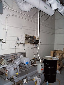

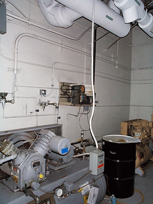

Hint: The branch-circuit conductors for this compressor were supplied through this liquidtight flexible metal conduit. Click here to see the answer. Hint: A threadless RMC coupling was used to connect this rigid metal conduit. Click here to see the answer. Hint: The gas company installed this gas line to supply a water heater that was located in the garage of a new house under construction. Click

Hint: Where is the thermostat wiring?

This new air compressor was installed to provide some additional services for the customers of a local convenience store. This metal jacketed cable assembly is not recognized for this use by any edition of the NEC in Chapter 3 under any circumstances, and will eventually fail. Also, connecting the cable to the cover of the lighting pole to pick up the supply for this equipment is not correct.
