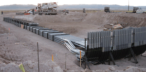

Many project owners have seen benefit from using underground and “in-the-slip” electrical conduit installations, which refer to a type of electrical construction where conduit is embedded within the concrete walls during the slip-form construction process. However, accommodating this type of electrical installation brings with it a unique set of challenges. Nevertheless, it’s possible to achieve goals for industrial hygiene, provide ease of access, and leave room for future expansion when conduit is installed underground (Photo 1) or within the concrete walls of a structure.

What makes the cost estimate for underground PVC conduit so much less than overhead cable tray or overhead rigid metal conduit? Savings is achieved in materials and labor. Material costs are lower for underground conduit; the cost for underground PVC conduit is significantly less than that of rigid metal conduit. Labor cost is reduced in part because entire duct banks can be prefabricated off-site (Photo 2). This shifts expensive labor hours off the job site and minimizes project man-hour peaks. Using underground installation also eliminates the need for certain materials and installation for items such as overhead supports. Underground installation also reduces “crew stacking,” by allowing much of the electrical installation to take place early in the job. While each project is different, financially speaking, underground installation merits consideration.
