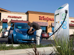

Already, Walgreens, the Deerfield, Ill.-based pharmacy and retailer, plans to offer electric vehicle (EV) charging stations at approximately 800 locations across the country by the end of the year, making it the nation’s largest retail host (Photo 1). The charging stations will feature either a high-speed direct current (DC) charger that can add 30 miles of range in as little as 10 minutes of charging time, or a Level 2 charger that can add up to 25 miles of range per hour of charge.
Major markets expected to host these sites include Boston, Denver, Los Angeles, New York, San Francisco, and Washington, D.C. Select locations in Florida, New Jersey, Oregon, Tennessee, and Washington will also receive EV charging stations. Installation began in late July. Walgreens already has installations under way for EV charging stations at more than 60 stores across Houston, Dallas/Fort Worth, and Chicago.
“Consumer interest and enthusiasm has been incredible, and we’re excited to provide locations to charge up in neighborhoods across the country," said Walgreens President of Community
Management and Operations, Mark Wagner in a press release announcing the roll-out of the EVSE at the stores. “As more Americans embrace environmentally sustainable technologies, our convenient locations make us uniquely positioned to help address the concern around accessibility or ‘range confidence.’"
According to the U.S. Department of Energy (DOE), Walgreens will make up as much as 40% of all public EV charging stations across the country (click here to see Map).
