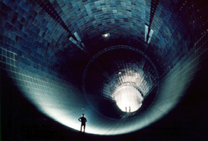

In the photo, new drives/motors at the Arnold Engineering and Development Center’s Propulsion Wind Tunnel Facility power propeller fans that drive wind through the tunnels at supersonic speeds for the testing of scale-model aircraft.
