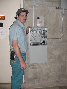

Realizing that he couldn’t save what he didn’t measure, Ron Barham, operations/electrical manager for the San Diego Convention Center Corp., investigated the situation and suggested that the convention center select a submetering system that would allow facility engineers to monitor, record, and report energy usage as a tool for conserving energy and for lowering overall operating costs. The selection of the system was based on price, customer service, and flexibility in allowing future expansion. The company also needed a hybrid solution in order to record power consumption and demand and monitor power factor, total harmonic distortion, and other power quality parameters.
The facility’s main electrical service entrances are located in two large sub-level electrical vaults, where multiple 480V 1,600A and 3,200A loads are individually submetered. Low-voltage output current sensors, installed around the electrical feeds in both vaults, supply the raw electrical data to five submeters in the west vault and four in the east. A computer interface module in each vault accumulates pulse outputs from the individual submeters, digitizes the data and transmits it via RS-485 communications link 1,600 ft to the laptop PC in Barham’s office.
