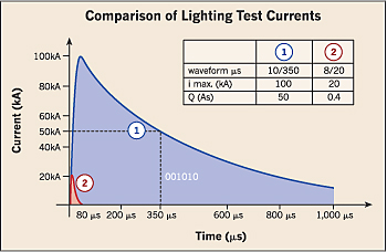

One manufacturer produced a diagram (at right) to show that a 100kA 10/350ìsec impulse delivers 125 times as much discharge in amps as a 20kA 8/20ìsec pulse. And use of an MOV protector for a 100kA 10/350ìsec pulse would require about 2,500kA 8/20ìsec MOV capability.
In reality, there’s no ANSI/IEEE-tested, low-voltage SPD on the market rated anywhere near 2,500kA. It’s understood that a TVSS rated at 400kA 8/20ìsec is more than sufficient for even the most extreme lightning environments.
