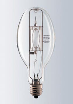

Shape = Performance. The part of the lamp that emits the light is the arc tube. In the design of the arc tube, shape is critical to performance. The pinched body arc tube is made from a cylindrical quartz tube with roughly straight walls, while the formed body quartz tube is produced with walls that are curved to follow the profile of the light-producing electric arc. To close the cylindrical tube, manufacturers pinch the ends, which gives the technology its name.
Arc tube geometry is a major factor in controlling thermal characteristics of the lamp. Pinching, or closing the ends of, a large cylindrical tube is very limiting from a lamp design standpoint. But a formed body arc tube allows the lamp designer to optimize the thermal profile of the arc tube to achieve the desired lamp performance characteristics (See Figure).
An MH lamp designer strives to create an arc tube that will heat the metal halides to the highest possible temperature without exceeding the thermal limits of the arc tube materials. Formed body arc tubes with hotter end regions accomplish this better than cylindrical arc tubes do. These formed body arc tubes optimize lamp performance by controlling temperature, which, in turn, increases efficacy and improves color uniformity. The result is a high quantity and quality of light from the lamp.
Benefits of formed body arc tubes. Formed body arc tubes also provide better repeatability of geometry, or lamp-to-lamp performance consistency. In applications where consistency of light output and color are paramount, this kind of lamp gives you a distinct performance edge.
The small end chambers of the formed body arc tube reduce end heat losses and, consequently, increase lamp efficacy. That means a significant energy savings for you—typically 28% over traditional MH technology.
Geometric inconsistencies are reduced even more in the lower wattage (300W and 320W) pulse start lamps recently introduced to the market. This is due to the formed body arc tube’s tipless design. This design is possible because of a manufacturing process that injects the halides and gases through the end of the arc tube, thus eliminating the need for an exhaust tube. The halides distribute evenly along the arc tube wall, resulting in further improvement in color quality.
