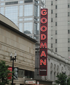

Sparkling lights now illuminate the neighborhood, which is only a short walk from the Chicago River and Michigan Avenue. At the corner of Dearborn and Randolph, a limestone, 170,000-sq-ft theatrical complex spans a city block, and a sparkling red fiber optic and neon marquee marks the entrance to the new Goodman Theatre.

  • The red marquee outside the Goodman Theatre is 73 ft tall and features 4 ft tall stainless steel letters that spell out “Goodman.” Each letter includes both red neon lights and fiber optic lights, which can change hues and patterns (Campbell is pictured with the sign above).
