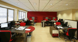

    The largest single user of electric power in an average building, lighting is slowly shifting toward solid-state sources — light-emitting diodes (LEDs) and organic LEDs (OLEDs), which are usually served at 12VDC or 24VDC. These luminaires would typically be smaller and lighter than standard ceiling fixtures, thus making it easier to install and change out ceiling fixtures and sensors/controls when a space is reconfigured.
    For many years, the workplace has included overhead lighting and a variety of electrical devices that are typically installed and wired for a building’s lifetime rather than occupants’ changing needs. Today, commercial buildings favor flexible furniture layouts, adaptable to each business project, rather than fixed desk locations.
