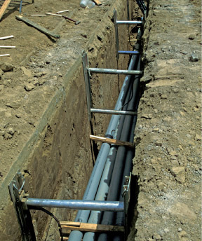

The OSHA standard can seem quite flexible, for example, allowing contractors substantial leeway on the types of trench protection they can use (Photo 1 on page C16). Therefore, some states have stricter guidelines than the federal rules. Designated state agencies in 20 states overrule OSHA in setting and enforcing safety regulations. “OSHA is a safety net that spreads everywhere with the possible exception of university campuses,” Hein says. “But some states' jurisdictions supersede OSHA's.”
